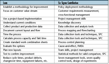

The lean approach offers a set of solutions to
muda in a high-variety production environment. Six sigma applies to the problems addressed by lean but also seeks to solve other problems common to production. However,
because both six sigma and lean address the problem of muda, there is a great deal of overlap. The approaches should be viewed as complements to one
another. Some examples of this synergism are shown in Table 1. Table 1: The Synergy of Six Sigma and Lean Production
If you're facing a situation where lean solutions can be used (e.g., high-variety
production), you shouldn't hesitate to implement lean: It offers proven solutions to known problems. Six sigma methods will help you with lean, and they will
help you continue to improve when it's time to move into administrative and other nonproduction areas. About the author
