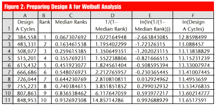

Modeling the data using Weibull analysis requires some preparation. For now, focus on the data from Design A.
1.Open Excel and into cell A1, type the label: Design A Cycles. Enter the failure data for Design A into cells A2:A11. Highlight cells A1:A11 and click on the Sort Ascending button to order the failure cycles from lowest to highest.
2.In cell B1, type the label: Rank. In cells B2:B11, type the integers 1-10 (see Figure 2).
excel2
3.In Column C, put an estimate of the proportion of the population that will fail by the number of cycles listed in Column A. This can be accomplished using several different methods, the most common of which is median ranks. In cell C1, type the label: Median Ranks. In cell C2, enter the formula: =((B2-0.3)/(10+0.4)). Next, copy cell C2 down through cell C11. Note that in the formula for median ranks, the 10 in the denominator is the total number of Design A units tested.
4.Type into cell D1 the label: 1/(1-Median Rank). Then, in D2, enter the formula: =1/(1-C2). Copy cell D2 down through cell D11.
5.Into cell E1, enter the label: ln(ln(1/(1-Median Rank))). In cell E2, type the formula: =LN(LN(D2)). Copy cell E2 down through cell E11.
6.Finally, you'll need to transform the Cycles data. In cell F1, type the label: ln(Design A Cycles). In cell F2, type the formula: =LN(A2). Copy cell F2 down through cell F11.
7.Again, compare your spreadsheet with Figure 2. After you confirm that everything is correct, save your workbook.

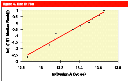

At this point, you're ready to perform the Weibull analysis. The beauty of this method is that you can expect to see a straight line when you plot the data in Column E vs. Column F.2 By performing a simple linear regression, you can obtain parameter estimates that will enable you to make inferences about Design A's reliability.3
First, be sure that the Analysis ToolPak Add-In is loaded into Excel. From the menu bar, select Tools . Add-Ins. Click on the checkbox for Analysis ToolPak, and then click OK.
To perform the simple linear regression:
1.While on the page you just created, from the menu bar, select Tools and Data Analysis. Scroll down and highlight "Regression" and click OK. A data-entry window will pop up.
2.Under "Input Y Range," type: $E$1:$E$11.
3.For "Input X Range," type: $F$1:$F$11.
4.Click to add a checkmark in the box for "Labels."
5.For "Output Options," select "New Worksheet Ply."
6.Click to add a checkmark in the box for "Line Fit Plots."
7.Click OK. Excel will perform the regression and place the output on a new worksheet.

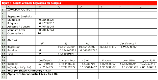

Reformatting the output
Before interpreting the output, you'll need to do some tidying up. The columns do not automatically adjust to their optimal widths. To do this, within the worksheet that you just created, click on column heading A and drag to column heading I. Now double-click on the boundary to the right of any column heading. Your table should look similar to Figure 3.

Now scroll to the right and click once on the graph. Stretch the graph by clicking and dragging on the handle in the lower right corner. From the menu bar, with the graph still selected, click View . Chart Window. Reformat the graph according to your preferences. It's best to use a solid line and no point markers for the Predicted line and delete the legend. Also, move the horizontal axis by clicking on the vertical axis with the right mouse button, selecting "Format Axis," clicking on the "Scale" tab and changing the "Value (X) Axis Crosses At" to -3 (see Figure 4).

In cell A19, type the label: Beta (or Shape Parameter)=. In cell B19, type the formula: =B18. In cell A20, type the label: Alpha (or Characteristic Life)=. In cell B20, type the formula: =EXP(-B17/B18). Your results should closely resemble Figure 3. For Design A, b=4.25 and a=693,380.4
An identical analysis using the Design B data yields a  Beta = 2.53 and an Alpha =723,105.

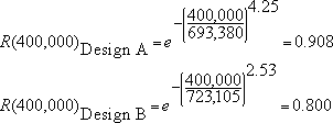

While this is interesting, it still doesn't reveal whether either jack-in-the-box design meets the reliability goal of R(400,000) Gte 0.90. For this, you need to know the formula for reliability assuming a Weibull distribution:
Eq1
where  x is the time (or number of cycles) until failure.
The formula looks intimidating, but by simply plugging in the known values for Alpha, Beta and x, you can obtain the desired reliability estimate.

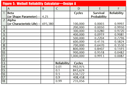

Creating a reliability calculator worksheet
1.From your Design A regression output worksheet, highlight and copy cells A19:B20. Activate a new worksheet ply and locate the cursor in cell A1. Select Edit . Paste Special, click on Values, and click OK. This will paste your Beta and Alpha labels and values into cells A1:B2 of the new worksheet. Resize the columns as needed.
2.In cell D1, type the label: Cycles.
3.In cells D2:D11, type the values 100,000-1 million in increments of 100,000.
4.In cell E1, type the label: Survival Probability.
5.In cell E2, type the formula: =WEIBULL(D2,$B$1,$B$2,TRUE).
6.Copy cell E2 down through cell E11.
7.In cell F1, type the label: Reliability.
8.In cell F2, type the formula: =1-E2.
9.Copy cell F2 down through cell F11.
10.Reformat cells as desired. Compare your worksheet with the top portion of  Figure 5.
excel5
You've now created a Weibull reliability calculator. You supply theAlpha, Beta and cycles of interest, and Excel calculates the reliabilities for you. By merely changing the inputs in cells B1, B2 and D2:D11, you can get reliability estimates for any Weibull distribution of interest.

We find that for Design A of the jack-in-the-box, R(992,975)=0.01, or 99 percent of the housings will have failed by 992,975 cycles.

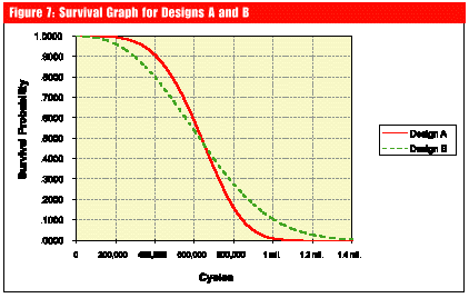

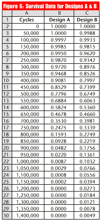

Perhaps the best way to compare the reliability of Design A with that of Design B is by using a survival graph. This line graph depicts the survival probabilities of each housing type at various numbers of cycles. Using the formulas discussed above, enter the data into a new worksheet (see Figure 6). Use the Chart Wizard to construct an X-Y scatterplot. Select line styles of your choice and delete the point markers. The resulting survival graph looks like Figure 7.
Figure 7 allows a comprehensive comparison of the two designs' survival rates. Note that at 400,000 cycles, about 90 percent of Design A housings have survived, whereas only about 80 percent of Design B housings have survived. Therefore, for the stated reliability goal of R(400,000) Gte 0.90, Design A is clearly superior. However, about 10 percent of Design B housings will survive to 1 million cycles, vs. fewer than 1 percent of Design A. This graph clearly shows the importance of defining the reliability goal in order to choose the more desirable design.
