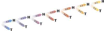

 The multiplication rule can be visualized in a probability tree:
There are four possible outcomes, barring the coin's landing on an edge, to flipping a coin twice. E1 is getting heads on the first flip and on the second flip; therefore, the probability would be one in four, or 25 percent. To calculate the probability of seven heads in a row, a probability tree can represent outcomes for seven flips:
That probability could also be determined by raising 0.5 to the seventh power:
 (0.5)7 = 0.0078
If Hartford Simsack--or anyone else--kept flipping a coin over and over from now until his birthday, the probability that he would get seven heads in a row is less than one percent.

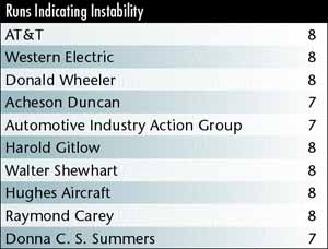

 This is good, but why seven? Why not eight? Why not six? For runs that indicate instability, various sources give different responses:
Who is right? The majority rule would favor eight. If you use the average, it would be 7.7, but don't forget that it was I who made the list. E-mail me and let me know what you think the correct number is, and I will get back to you in a future column.
