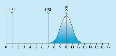

The data (Cp = 1, Cpk = -1.5) reflect a normal distribution, as illustrated in the figure below.
 Data Outside of Specification Limits
For ease of explanation, assume that the mean is 10 and the standard deviation is 1. Because Z- USL is a negative value (-3.0), the data would fall outside (to the right) of the upper specification limit.
 In order for this outcome to take place, the X-double bar must be greater than the upper specification limit. Simsack's data would appear as follows, with respect to the specification limits:
