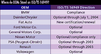

At an Automotive Industry Action Group-sponsored seminar on April 24, the Big Three automakers stood before their leading suppliers and stated the direction that their joint quality system capability assessment initiatives would take: ISO/TS 16949:2002 has been released, and QS-9000 is no longer in the long-term picture.
“We have no plans to revise QS-9000 based on ISO 9001:2000 because we believe ISO/TS 16949 comprehends QS-9000 and includes strengthening major areas,” said Joe Bransky of General Motors Corp. “ISO/TS 16949 contains 90 percent of QS-9000 already, and it’s an improved standard.”
“DaimlerChrysler has already registered some of its own sites to ISO/TS 16949,” added Hank Gryn of DaimlerChrysler. “That’s a big signal which way we’re going.”
“Ford will be going to ISO/TS 16949 by 2006 at the latest,” said Ford Motor Co.’s Russ Hopkins. “We’re working on an announcement that will be forthcoming very soon.”

Since the April 24 rollout, DaimlerChrysler has released a letter dated July 2002, which stated that effective July 1, 2004, all product and service part suppliers to DaimlerChrysler are required to be registered to ISO/TS 16949. In early August, DaimlerChrysler, Ford and GM released a joint letter announcing that the third edition of QS-9000 will expire on Dec. 14, 2006, after which ISO/TS 16949:2002 will replace QS-9000. (Both letters can be downloaded from the AIAG Web site at www.aiag.org.)

IATF OEM options
The current options for IATF OEMs and others who subscribe to ISO/TS 16949 are:
Compliance. Certification is not required but must conform to the requirements.
Optional with upgrade urged. The current policy of Ford and GM
Phase-in. Start with a lead, major-commodity supplier organizations, and the rest will follow.
Mandate. Establish a deadline for first-tier suppliers that fall under applicability.
It’s not necessary for QS-9000-certified organizations that are adding ISO/TS 16949 certification to retain their QS-9000 certification unless customer requirements dictate otherwise.
