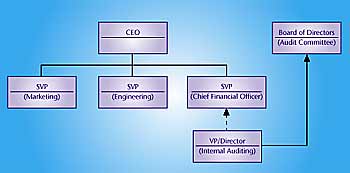

Internal Auditing Reporting Relationship

Senior management and an organization's board of directors are responsible for risk management and operational control processes. However, value-added auditors can also serve as consultants to assist the organization in identifying improvement opportunities, evaluating risks and implementing risk-management methodologies and controls. This is a major change in internal and other auditing disciplines, where it was assumed that an unassailable firewall stood between the auditor and auditee.
Traditionally, auditors were independent and objective. Independence implied that an arms-length relationship existed between the auditor and auditee. If the auditor provided the auditee with consulting assistance, the prevailing belief held that the auditor's independence might be impaired, although his or her objectivity to the auditee still provided value. The notion of auditor as consultant represents a major change in the Institute of Internal Auditing standards as quality and internal auditors evolve into "business process" assurance and consulting experts.
