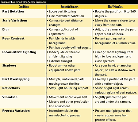

The Ten Most Common Vision System Problems
