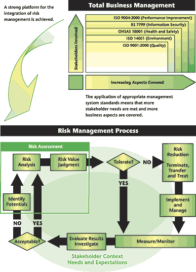

Identifying and evaluating risks
Risks can be seen positively as business opportunities, such as investing in an innovative new product, moving into new geographical markets or merging with another organization. Organizations that can effectively manage these risks are much more likely to protect and enhance their stock market valuation and expand their business.
In a more traditional—i.e., negative—sense, risk is usually seen as a potential for loss, whether it’s lost revenue, litigation, claims or harm to people, property or the environment.
In fiercely competitive manufacturing industries that use just-in-time techniques, late delivery from a supplier means production downtime and unhappy customers. Claims for lost revenue and damage to reputation ricochet down the supply chain, destroying the financial viability of otherwise successful businesses. Aside from the obvious negatives incurred when people or the environment are injured, the inevitable and damaging press coverage that follows can destroy shareholder confidence and business value.
The risks associated with less-tangible assets, such as an organization’s brands, must also be carefully evaluated. Brands take years and significant financial investments to build but only seconds to destroy. For example, air traffic controllers have recently charged the pilots of some low-cost airlines in the United Kingdom with putting efficiency above other criteria. Would you fly with an airline with a poor safety record?
After all the necessary business information is gathered, the next step in a risk management process is to perform a risk assessment. This may seem more of an operational issue, but in fact it requires a companywide approach. Risk can be inherent in an acquisition opportunity just as much as it is in an accident.
Organizations that have successfully applied the environmental management system standard ISO 14001 have reviewed their operations with respect to significant environmental issues (e.g., air and water emissions, waste management, land contamination, raw materials and natural resources, and other local environmental and community concerns). As part of the process, the standard helps these companies respond to a common stakeholder expectation: managing risk and preventing loss with respect to the environment.
Organizations that have successfully applied OHSAS 18001 have identified hazards and performed risk assessments relating to routine and unusual activities performed by anyone who has access to the workplace, even subcontractors and visitors. They’ve also extended this examination to workplace facilities, whether the organization or an outside supplier provides them. Organizations that adopt this standard not only establish a culture of risk management, but also address another key stakeholder concern: the people within the organization.
Essentially, the challenge to organizations is to master the risk assessment process and apply it companywide. Once the process is adopted for obvious concerns, such as those related to waste management or heavy machinery, it can be used to evaluate less tangible assets—like brand management. Again, the environment in which an organization works—and this includes the stakeholders who influence how it operates—is a key prerequisite and shouldn’t be forgotten.
Managing risk through an integrated system
Once risks have been identified, a company must decide how it plans to tolerate, terminate, transfer or treat them. Treating a risk is often the most complicated choice because it requires control and measurement. These form the foundation of an effective management system.
Difficulties arise when an organization determines that a risk falls outside its management system’s usual scope. For example, a risk might be identified in information security and how information is collected, stored, maintained, accessed and communicated throughout the business and to other stakeholders. By adhering to the requirements agreed upon by industry and applying appropriate management system safeguards, such as those outlined in the information security standard ISO 17799, the organization can improve its current system and mitigate significant risks.
Another aspect of managing risks through treatment is maintaining the balance between competency and procedure. Organizations that have implemented ISO 9001:2000 are aware that it’s often more appropriate to manage a process by means of competent personnel rather than requiring them to follow meticulous, step-by-step instructions. This philosophy also applies to risk management: By its very nature, risk can’t always be controlled through checklists.
Using the skills of a trained and highly competent staff is a very effective method of managing risk. Proper training and experience allow staff to identify inherent risks in given situations and quickly work out the most appropriate course of action. This implies a very different culture from one in which staff is expected to work methodically through detailed procedures before filling in the required documentation.
When managing risk, it may therefore be appropriate to build in checkpoints along a process to measure and identify potential risks. Staff competency can be matched to perceived risks at each stage in the process, ensuring that the risks are managed safely. Employee competency can be tested periodically, which will in turn help drive training programs and succession planning.
Most management system standards require that an organization measure its performance against objectives. For organizations that have successfully implemented management system standards, these measurements can be applied to risk management. Also, because processes are already in place to measure and analyze information, additional data required for risk management can be more readily obtained. For example, a company might decide that storing a particular manufacturing byproduct beyond an established amount is an unacceptable risk. To monitor and continuously evaluate this risk, the company can determine from the sales process the number of orders anticipated and from those figures, the corresponding amount of byproduct expected once production is completed. A process can then be developed to ensure that when the byproduct exceeds the established storage amount, it’s safely disposed of or recycled.
Any business using an integrated approach that includes risk management will be able to provide objective evidence to top management, who can use the information to ensure the organization’s health and implement continuous improvement through management review. Applying a management system standard ensures a structured approach to fact-based decisions about the organization’s future.
One system for best practices
Is risk management an independent issue, something that must be managed separately from everyday operations? Evidence indicates that most organizations are already managing risk through their management system standards.
Building upon what’s already in place is often the most appropriate way forward. Perhaps the true challenge for organizations today isn’t identifying and managing risk but figuring out how to establish a culture based on a single business management system that can be used to apply best practices.
Internationally recognized standards can help organizations assess all their stakeholders’ needs and expectations. The results of internal and external audits to these standards can be used to drive organizational risk management. The whole system must have a continual improvement focus in line with strategic objectives in order to safeguard the organization’s future prosperity. Such a system could be described as a total business management system.
