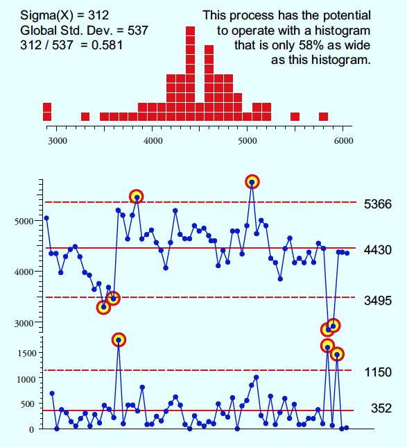

Figure 1 shows a process behavior chart for 64 data. The histogram is characterized by the global standard deviation statistic of 537 units. This value describes the past performance of this process. Unless this process is changed in some way, we can’t expect to do any better than this in the future.
In contrast to the value above, the within-subgroup measure of dispersion used to compute the limits on the chart is denoted by the label Sigma(X) and is computed as:
In Figure 1, we have an XmR chart, so Sigma(X) becomes:
This value characterizes what this process is capable of producing when operated up to its full potential.
The ratio of Sigma(X) to the global standard deviation statistic compares the process potential with the process performance. In this case, this ratio is 0.581. Thus, based on these data, this process has the potential to operate with a histogram of outcomes that’s less than 58% as wide as the histogram shown.
Figure 1: The potential for improvement
This simple ratio gives an estimate of how much a process can be improved by simply operating it up to its full potential. When the statistics come from an unpredictable process, as happens here, this ratio will be conservative. In practice you can usually do even better. So, by computing this ratio for various process steps, you can choose to work on that process step which offers the greatest potential return on your effort. This is how a process behavior chart can help you to know where to start your improvement project.

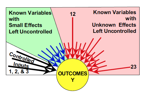

Here, you need to discover how to operate your process on target with reduced variation. But the problem is how to accomplish this. A cause-and-effect diagram can list dozens or hundreds of causes, and experiments simply can’t handle such large numbers of variables. As shown in Figure 2, causes 1, 2, and 3 are the controlled process inputs, while causes 4 to 23 are left to vary during production. In this case, it’s the controlled causes that determine the process average, and the uncontrolled causes that create the process variation.
Figure 2: The known variables
To improve this process, you’ll need to identify causes 12 and 23 as having dominant effects, and then make these two causes part of the set of controlled process inputs. But to find causes 12 and 23 with an experimental approach, you’ll need to quantify the specific effects of causes 4 to 23. So the first problem with an experimental approach is the large number of known cause-and-effect relationships that need to be studied.

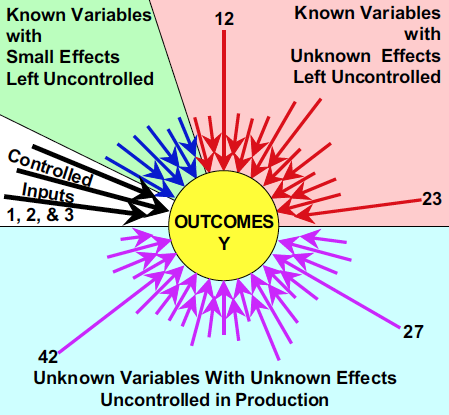

Moreover, an experimental approach can’t tell the whole story. Even if you had time to experiment with every cause on your cause-and-effect diagram, you still couldn’t experiment with the unknown cause-and-effect relationships shown in Figure 3.
Figure 3: Known and unknown variables
These unknown causes are the unintentional process inputs that go along with any production operation. They range from leaking hoses to poorly written operating instructions; from changes made by your suppliers to tampering by managers or operators; and from dumb things that happen to design flaws in the process—they’re the unforeseen, the overlooked, the forgotten, and the unanticipated. Yet, while these causes are unknown, they’re real and have real effects. Whenever cause 27 or 42 changes, it will take the whole process along for the ride. So the second problem of the experimental approach to process improvement is its inability to deal with unknown factors.
Any cause, known or unknown, with a dominant effect that’s not part of the set of controlled process inputs can take your process on walkabout, causing it to operate off target with increased variation. Experimentation may let you eventually find causes 12 and 23, but experimentation can’t discover the unknown variables 27 and 42 that have dominant effects. So what are we to do?
Rather than trying to determine the effect of each known cause individually, we need to characterize the effects of all of the causes, both known and unknown, collectively. When the uncontrolled causes all have similar-sized effects, the variation in the process outcomes will be the result of a large number of causes where no one cause is dominant. This will result in a pattern of variation that is steady-state and unchanging over time.
But when some dominant causes like 12, 23, 27, and 42 are present, the variation in the process outcomes will show upsets, changes, and shifts over time as these dominant causes change levels. Thus, by looking at the variation in the process outcomes over time, we can simultaneously examine all of the known and unknown causes to see if there’s evidence of any dominant cause-and-effect relationships among the uncontrolled variables.
The way we do this is by using a process behavior chart. When the process behavior chart shows the process is going on walkabout, we can usually identify causes 12, 23, 27, and 42 by studying those points in time where the process changes.

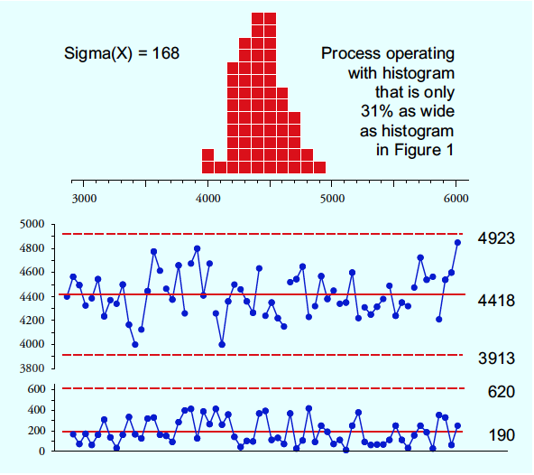

The effect of these changes can be seen and evaluated using a process behavior chart. Figure 4 shows what happened to the process in Figure 1 after they found the assignable causes and controlled their effects.
Figure 4: The improved process
By finding and controlling those causes with dominant effects, they were able to operate with a histogram that was only 31% as wide as that of Figure 1. With no further signals of exceptional variation, this process is operating with minimum variation. They improved their process, and they can document this improvement using the chart. So, process behavior charts help the improve step of DMAIC.
