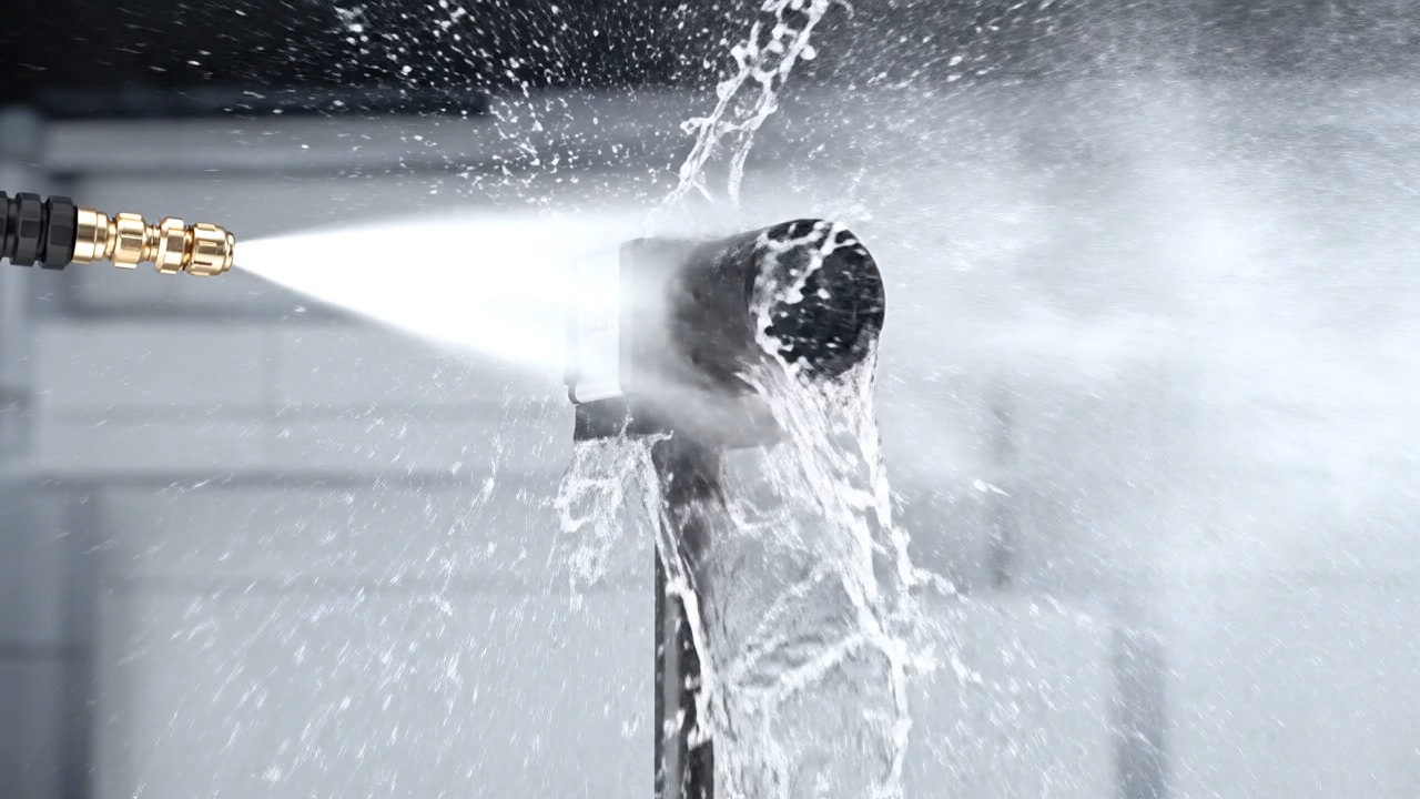

(IDS: Obersulm, Germany) -- IDS Imaging Development Systems adds to its uEye FA series with 2–12.5 MP Sony STARVIS 2 rolling shutter sensors. The IP69K-rated uEye FA models provide high image quality, even in challenging lighting conditions.
When production systems are cleaned using high-pressure jets, operate in dusty environments, or are exposed to subzero temperatures, effective machine vision solutions are required. The uEye FA series from IDS has been specifically designed for such demanding environments, featuring IP69K protection.
This provides users with high-performance cameras for a wide range of industrial applications with varying lighting conditions, from manufacturing automation to quality inspection. The new models incorporate sensor variants IMX662 (2 MP), IMX664 (4 MP), IMX675 (5 MP), IMX678 (8 MP), and IMX676 (12.5 MP). All are GigE Vision-compliant, allowing easy integration into existing systems.
The Sony STARVIS 2 sensors feature exceptional light sensitivity extending into the near-infrared (NIR) range, very low noise levels, and the Clear HDR process for an expanded dynamic range. This captures detailed, sharp images even in demanding environmental conditions. An asynchronous exposure trigger further enhances their suitability for industrial use.
The camera hardware itself has also been designed for industrial applications. Thanks to the IP69K-protected housing, lens tube, and corresponding cabling, the cameras operate reliably even under high pressure, heavy contamination, or temperatures down to –20°C.
