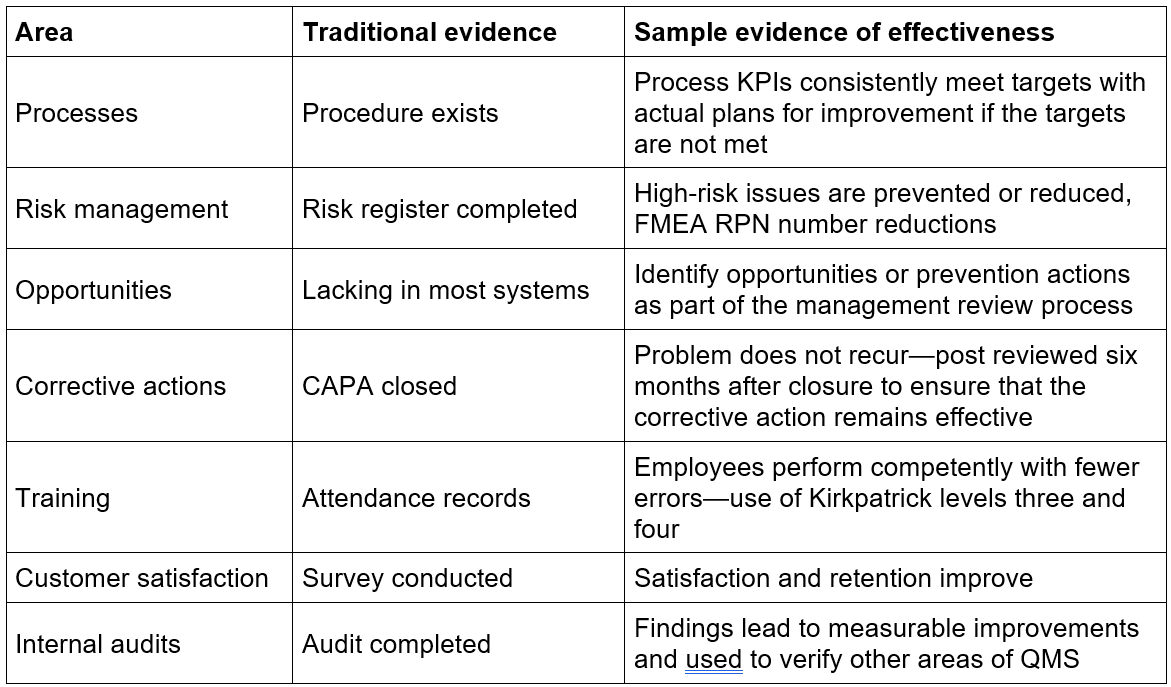

Recommendations
From the registrar’s view, this is most commonly seen during the audit finding reviews after a formal site evaluation, where companies will list the plan for correction, the actual correction, and a weak root cause analysis. What is most often missing is whether the correction to the problem actually worked. In future audits, I will be looking for a lot more evidence (documented) that the organization has done some form of evaluation to verify the effectiveness of corrective actions as well as the other areas mentioned to this point.
So what are some practical suggestions to manage the effectiveness requirements by not creating new documents but looking at ways to demonstrate that your quality management system consistently achieves its intended results? The aim should be to build effectiveness into every level of the QMS.
Other areas that could be considered include:

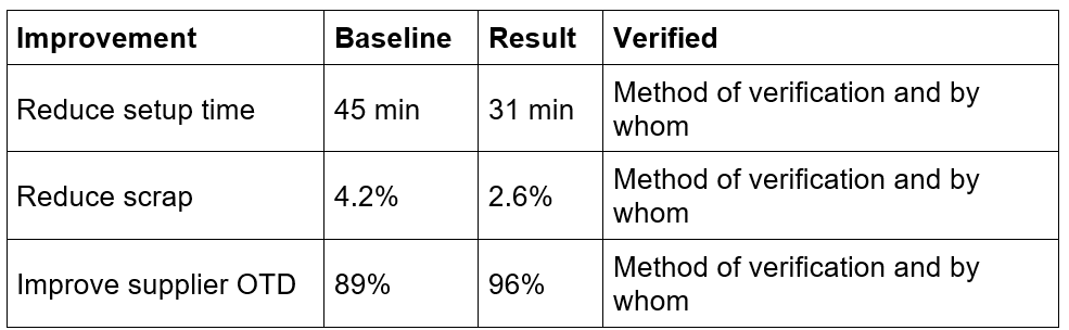

8. Measure continual improvement
Maintain an improvement register showing:
This demonstrates that improvement activities produce measurable results.
