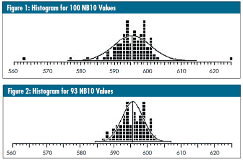

For example, the histogram in figure 1 has a bell-shaped curve superimposed. This curve is based on the average and standard deviation statistic for all 100 values in the histogram. It’s neither wide enough nor tall enough to provide a good fit to the data. The histogram in figure 2 contains the 93 values left after the seven extreme values (the four lowest and three highest) were deleted. Now the curve based on the average and the standard deviation statistic does a much better job of fitting the data. Thus, it’s true that outliers can undermine our efforts to create a model for our data.
