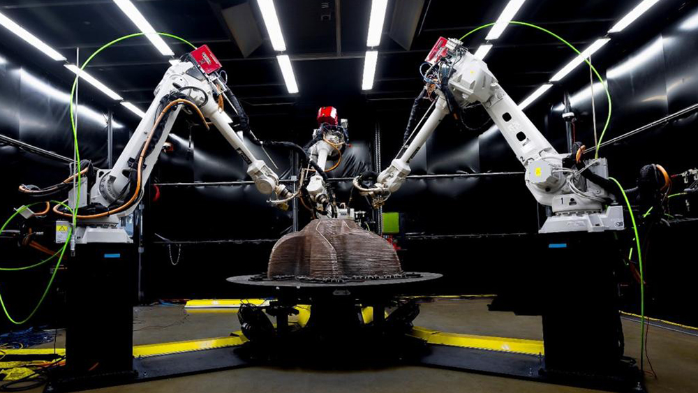

Senior research scientists Jason Mayeur and Soumya Nag are innovating to push PM-HIP far beyond its decades-old origins with the addition of process improvements—including the use of 3D-printing methods like wire-arc additive manufacturing, or WAAM, and hybrid (additive and subtractive) manufacturing, as well as in-situ monitoring and advanced computational modeling. These techniques can create PM-HIP molds faster and more accurately. In turn, PM-HIP is made not only more precise and effective, but also more affordable and more viable for American manufacturing.

In contrast with traditional casting and forging techniques, the PM-HIP manufacturing process involves fabricating pre-formed, hollow molds for each large-scale component and filling them with metal powder. Once the 3D-printed mold, also known as a “can” or “capsule,” receives an initial seal, any gas remaining inside is pumped out. Then, a more permanent, hermetic seal is applied.
At this point, the capsule is heated and pressurized in prescribed cycles within a hot isostatic press, or what is essentially a pressurized furnace. Without melting, these cycles facilitate the consolidation of the metal powder into the required shape in a process exchange of heat and pressure known as solid-state bonding. When bonding is complete, acid leaching or machining is used to remove the exterior can, revealing the intended part.
