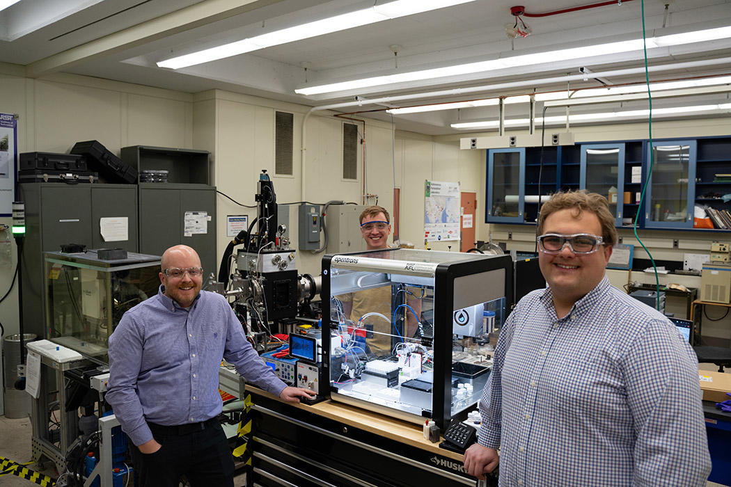

Reformulating a consumer product can take months of research and a lot of money. In the Autonomous Formulation Laboratory at NIST, AI helps develop “recipes” that can then be tested as part of product development. Credit: M. King/NIST

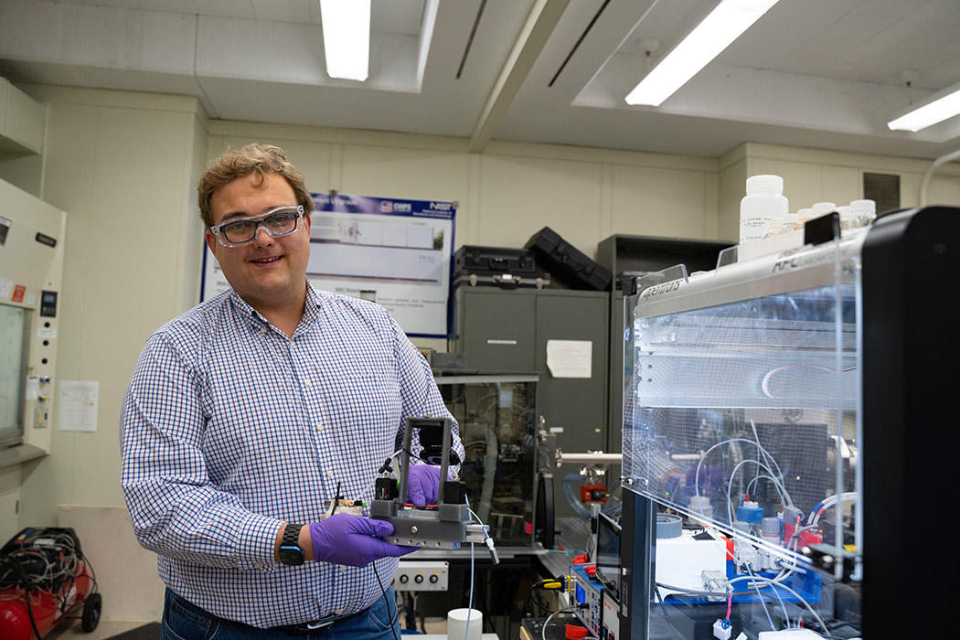

NIST researchers Tyler Martin (left front), Peter Beaucage (right front) and Duncan Sutherland are using AI to help speed up and improve the product formulation process. Credit: M. King/NIST

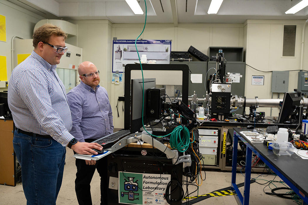

NIST researchers Peter Beaucage (left) and Tyler Martin (right) working in the AFL lab at NIST. Credit: M. King/NIST
