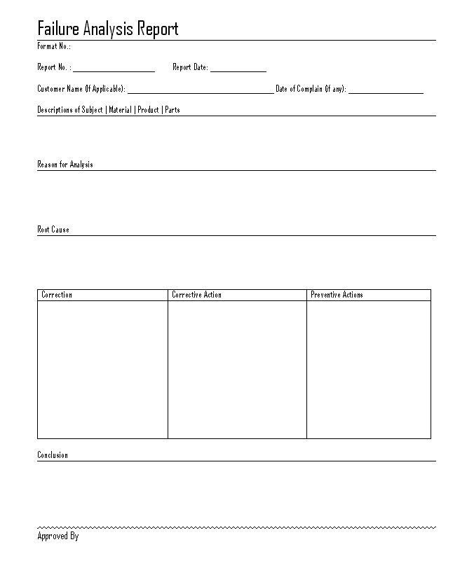

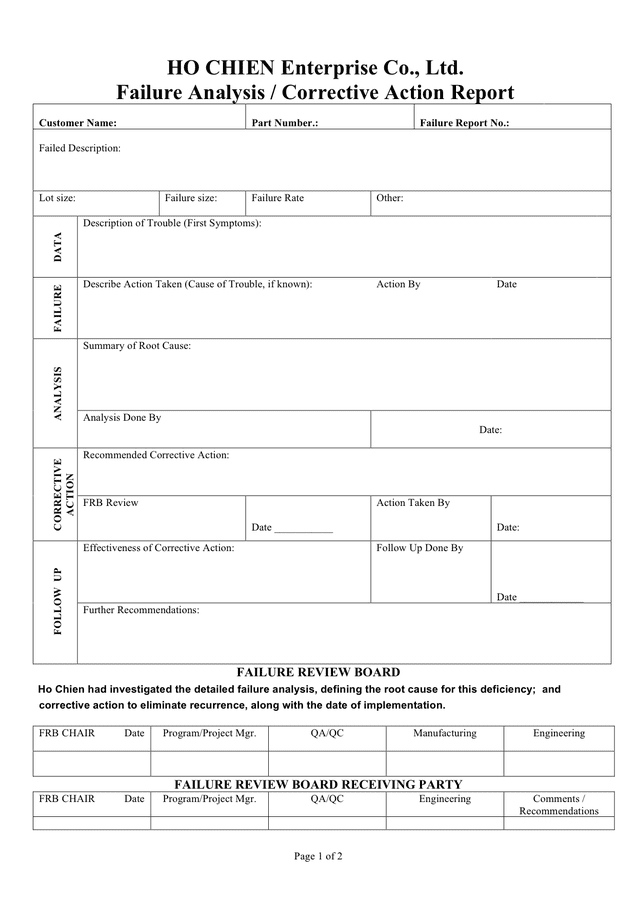

This might still sound rather abstract, so let’s look at some templates.
Failure analysis report examples
A sample of a basic failure analysis report. Source: Inpaspages
More comprehensive failure analysis report form. Source: Dexform
You can find many other examples on the web by searching for “failure analysis report” and taking a look at Google’s “Images” section.
