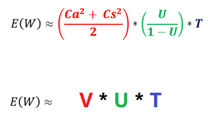

One of my favorite equations from Factory Physics, by Wallace Hopp and Mark Spearman (Waveland Press, third edition, 2011) is Kingman’s formula, usually represented as “VUT.”
The VUT equation is named after Sir John Kingman, a British mathematician:

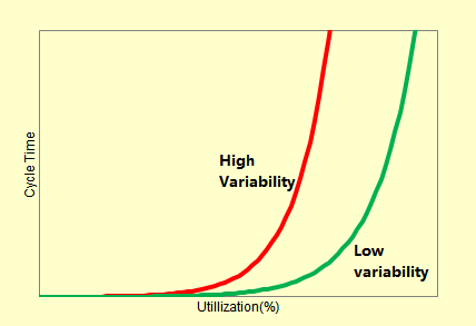

The first factor represents variability and is a combination of variability factors representing arrival and service times (e.g., flow variability and process variability). The second factor represents utilization of the workstation or the assembly line. The third factor represents the average processing time in the workstation or the assembly line. The VUT equation shows that the average cycle time or wait time is proportional to the product of variability, utilization, and process time.
The most important lesson from VUT is: If a station increases utilization without making any other change, average work in process (WIP) and cycle time will increase in a highly nonlinear fashion.
