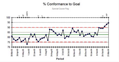

The use of "Percent Conformance to Goal" takes the data far out of context.  What exactly is being measured? Percent of what? Are the percentages calculated based on rational subgroups?
Shouldn't a run chart be based on actual individual measurements?
