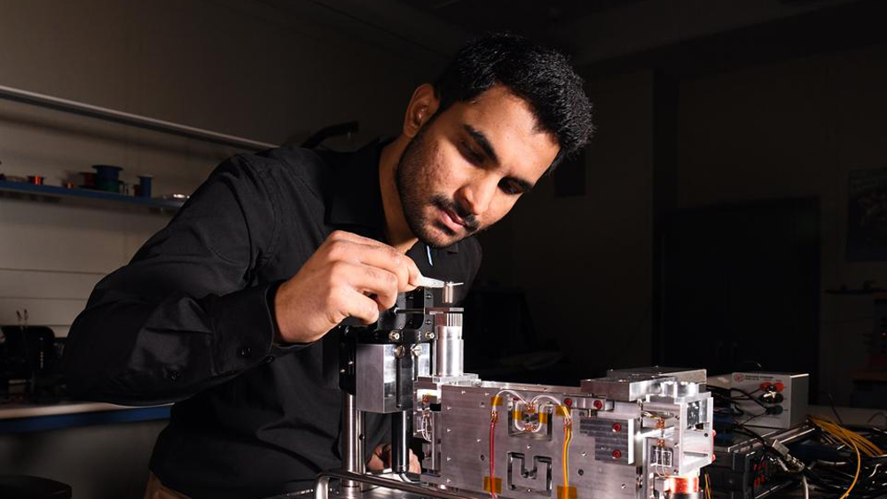

NIST engineer Kumar Arumugam examines the tabletop Kibble balance before its delivery to the U.S. Army. Photo: J. Lee/NIST
