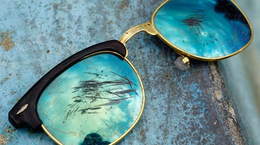

Scratches: Product failure or process failure?

The following example is provided by the author as an improper FMEA:
Potential failure mode: Part scratched Potential effect(s) of failure: Customer rejects part Severity: 5 Cause(s)/mechanism(s) of failure: Operator did not detect the scratch Recommended actions: None (because the occurrence was rated at 5 and detections at a 4, which makes the total risk priority number = 100). Typically, organizations do not apply a risk treatment to RPN values at or under 100.
Contrary to what the article states, the problem with the example is not the ”Part Scratched” failure mode.  This is actually a legitimate failure mode assuming scratches are an out of spec condition.  The three major problems with the example is the cause listed and the fact that the author left out two critical columns of the Process FMEA.  “Operator did not detect the scratch” is not a failure cause.  There are 10 different types of root causes that all processes should be examined for.  One of those is mishandling of parts.  In the example provided by the author, operators can create scratches by stacking parts on the conveyor.    Consequently, our failure cause is “Operator stacks parts on conveyor”.   The proper definition of the root causes of process failure is the most important step of the Process FMEA process since it allows us to define the required “Prevention Controls”.  The Prevention control column describes how the failure causes (sources of incidents that lead to exposure to harm) will be prevented.  This column contains the primary risk controls for the process.
